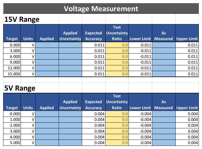

12.1.2. Voltage Validation Process#
  1. Connect calibrator OUT terminals to the Joulescope IN terminals, observing polarity.
  2. Connect a load to the Joulescope OUT terminals if recommended by your calibrator. Otherwise, leave the OUT terminals unconnected.
  3. In the Joulescope UI, select Voltage Range to 15V.
  4. Configure the calibrator to the target voltage.
  5. Record the actual calibrator voltage, the calibrator’s uncertainty at that voltage, and the Joulescope’s measured voltage as displayed by the Joulescope UI.
  6. Repeat 4 and 5 for each target voltage.
  7. Repeat 2 through 6 for the 5V range.
The following image shows the calibration spreadsheet:
Voltage validation spreadsheet
During the test process, you should fill in all light-blue cells with measurement data. All TUR values should be green. Yellow indicates that the test setup lacks sufficient accuracy. All “As Measured” values should be green. Red indicates that the Joulescope does not meet specifications.

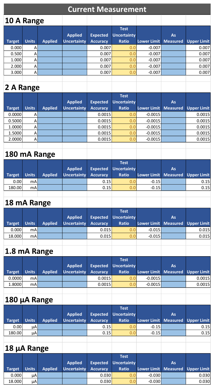

12.1.3. Current Validation Process#
The current calibration process can be performed using several methods. In all cases, the goal is to generate a current close to the target current. Strict accuracy on the generated current is not required. However, a reference measurement is required.
The general process is
  1. Select the Current Range in the Joulescope UI
  2. Configure the target current.
  3. Record the applied current as measured by the reference, reference’s uncertainty at that current, and the Joulescope’s measured current as displayed by the Joulescope UI.
  4. Repeat 2 and 3 for each target current
  5. Repeat 1 through 4 for each current range.
Current validation spreadsheet
Note that many of the test cases are for a 0.0 amp target current. In this setup, you can simplify the setup and leave the Joulescope instrument disconnected, or optionally short the Joulescope OUT terminals with a banana jumper wire.
Numerous valid test equipment methods exist to generate and accurately measure the target current. You may select a method that is appropriate for your equipment. The Joulescope has a very large current range, and you will need to accurately measure from 18 µA to 3 A. You may need to employ more than one method to cover the entire current range with a sufficient TUR. Possible methods include:
