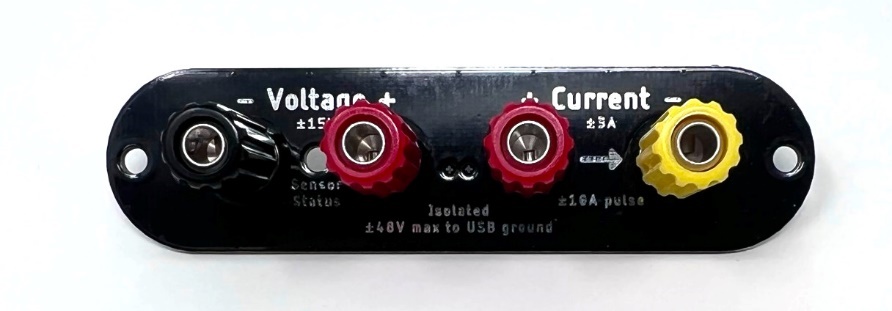

Joulescope comes standard with a banana jack front panel. However, Joulescope is designed to be flexible and can support other connector types.
JS320 swappable front panel
The front panel design is open source, and available on GitHub:
jetperch/js220_end_panels
The JS320 is fully compatible with all JS220 end panels and accessories.
To swap the front panel, you will need:
  • 2 mm Allen wrench (included)
  • The new front panel
