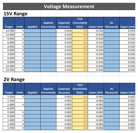

The following image shows the calibration spreadsheet:
Voltage validation spreadsheet for the 15 V and 2 V ranges
During the test process, you should fill in all light-blue cells with measurement data. All TUR values should be green. Yellow indicates that the test setup lacks sufficient accuracy. All “As Measured” values should be green. Red indicates that the Joulescope does not meet specifications.

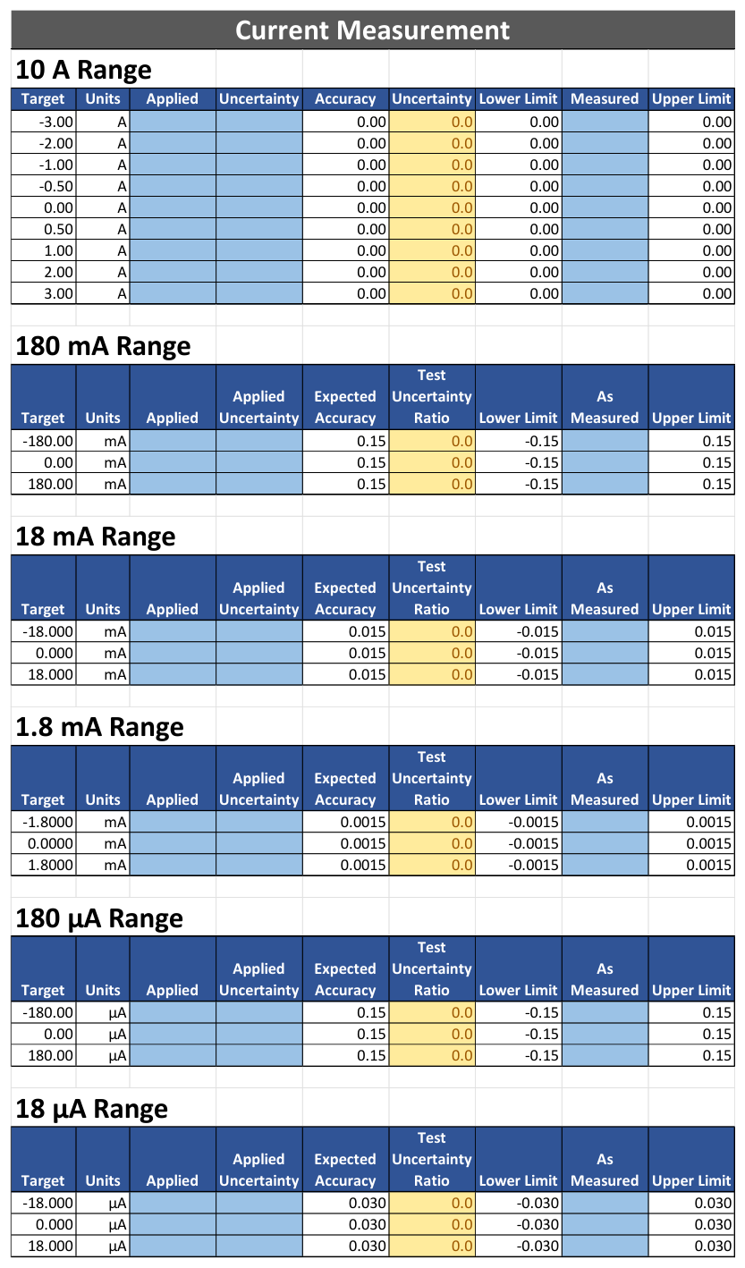

Current validation spreadsheet for each current range
Note that many of the test cases are for a 0.0 amp target current. In this setup, you can simplify the setup and leave the Joulescope instrument disconnected, or optionally short the Joulescope Current terminals with a banana jumper wire.

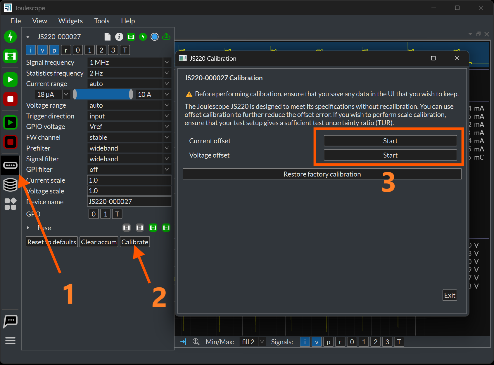

The JS220 supports offset calibration for both current and voltage. The Joulescope UI 1.0.40 and later includes offset trim calibration. Before starting a trim calibration, please run your JS220 for at least 5 minutes to allow the temperature to stabilize. To start a current offset trim calibration, select the Device Control widget in the sidebar, then press Calibrate:
Joulescope UI calibration dialog
Press Start for Current offset or Voltage offset, and follow the onscreen instructions. Ensure that you leave the terminals open for Current offset calibration. Short V-, V+ and I+ to perform Voltage offset calibration.
