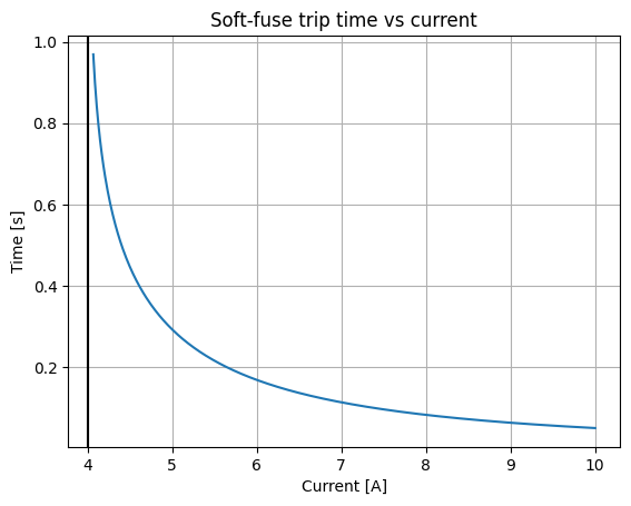

10.1. Max Fuse#
The Max Fuse protects your JS320 from over-specification current events. The engage time versus a fixed input current is:
Fuse engage time versus input current

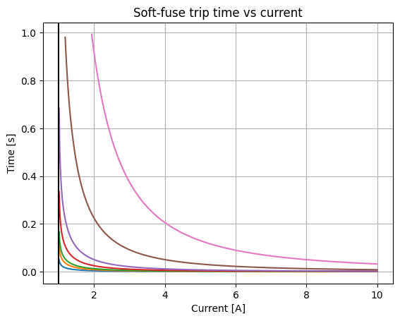

10.2. Range Fuse#
The Range Fuse protects your JS320 for each current range. This fuse is only meaningful when you manually select a fixed current range. While in the default “auto” current range mode, the JS320 will always autorange before this fuse engages.
The response for each current range is:
Fuse response for each current range

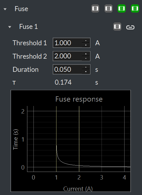

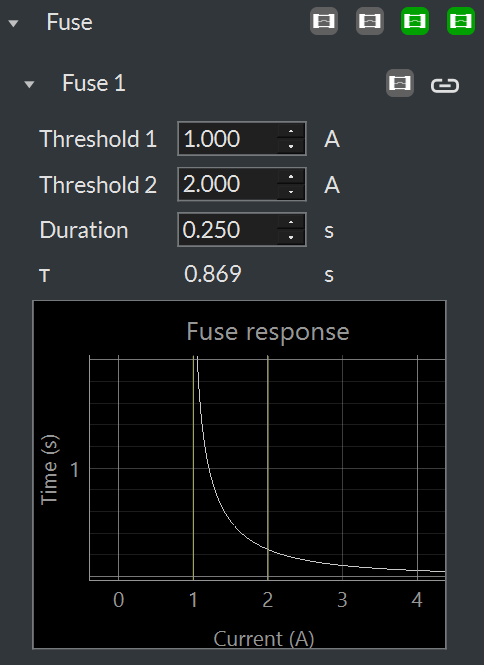

Specifying the two coefficients T and K directly is not intuitive. Instead, the UI allows you to specify two current thresholds and a duration. The first threshold is the minimum trip current. Any current less than this first threshold will never cause the fuse to engage. A constant current at the second threshold for the given duration will cause the fuse to engage. Together, these three constants determine the fuse response. When you select the constants, the UI will display the resulting response curve. The following figures show the response curve with the same thresholds but different durations:
Fuse settings and response curve with a 0.250 s duration Fuse settings and response curve with a 0.050 s duration
