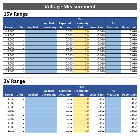

14.1.2. Voltage Validation Process#
  1. Connect calibrator OUT terminals to the Joulescope Voltage terminals, observing polarity.
  2. Connect Voltage + to Current +. Leave Current – open.
  3. In the Joulescope UI, select Voltage Range to 15V.
  4. Configure the calibrator to the target voltage.
  5. Record the actual calibrator voltage, the calibrator’s uncertainty at that voltage, and the Joulescope’s measured voltage as displayed by the Joulescope UI.
  6. Repeat 4 and 5 for each target voltage.
  7. Repeat 2 through 6 for the 2V range.
The following image shows the calibration spreadsheet:
Voltage validation spreadsheet for the 15 V and 2 V ranges
During the test process, you should fill in all light-blue cells with measurement data. All TUR values should be green. Yellow indicates that the test setup lacks sufficient accuracy. All “As Measured” values should be green. Red indicates that the Joulescope does not meet specifications.

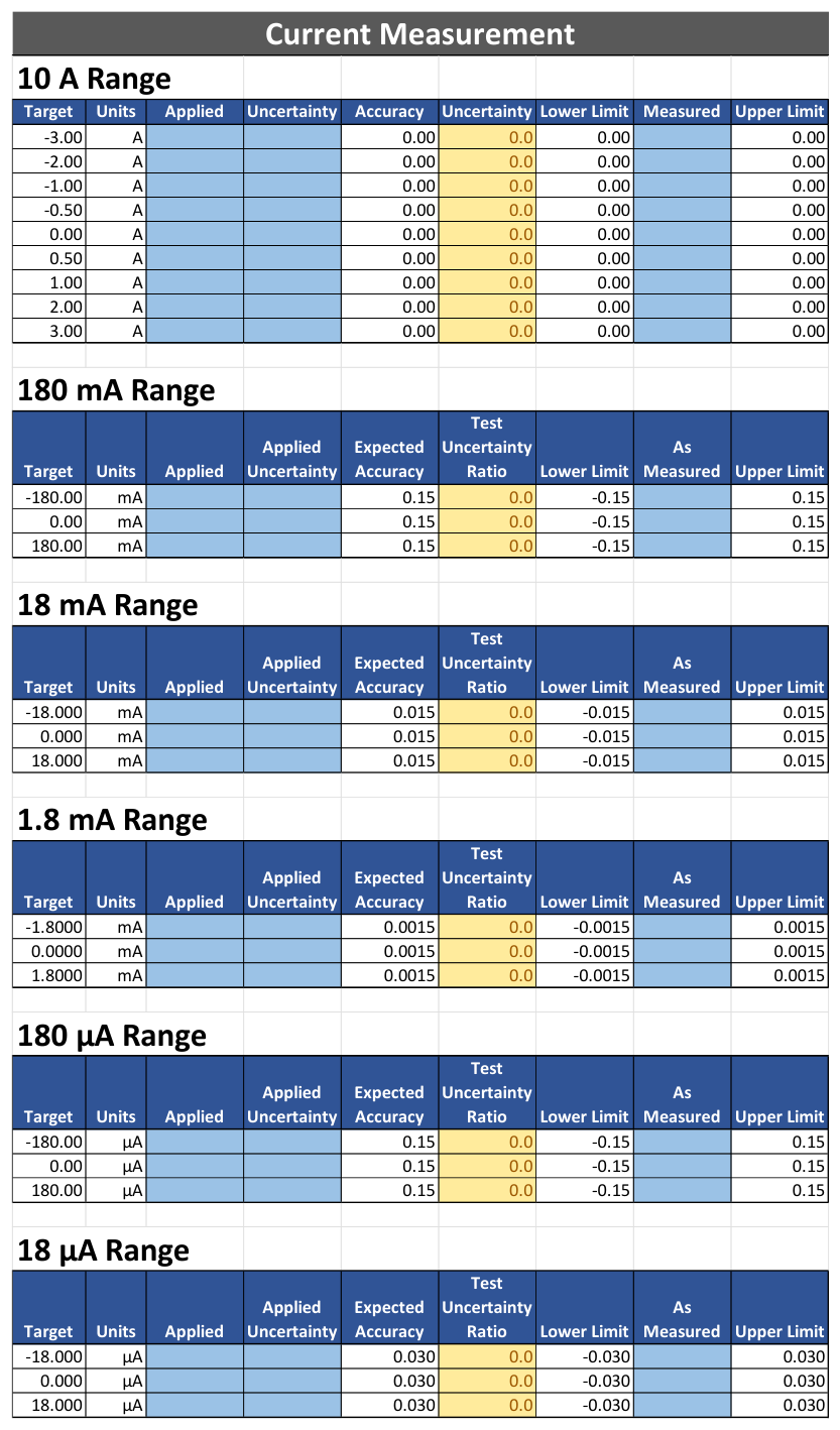

14.1.3. Current Validation Process#
The current calibration process can be performed using several methods. In all cases, the goal is to generate a current close to the target current. Strict accuracy on the generated current is not required. However, a reference measurement is required.
The general process is
  1. Select the Current Range in the Joulescope UI.
  2. Configure the target current.
  3. Record the applied current as measured by the reference, reference’s uncertainty at that current, and the Joulescope’s measured current as displayed by the Joulescope UI.
  4. Repeat 2 and 3 for each target current
  5. Repeat 1 through 4 for each current range.
Current validation spreadsheet for each current range
Note that many of the test cases are for a 0.0 amp target current. In this setup, you can simplify the setup and leave the Joulescope instrument disconnected, or optionally short the Joulescope Current terminals with a banana jumper wire.

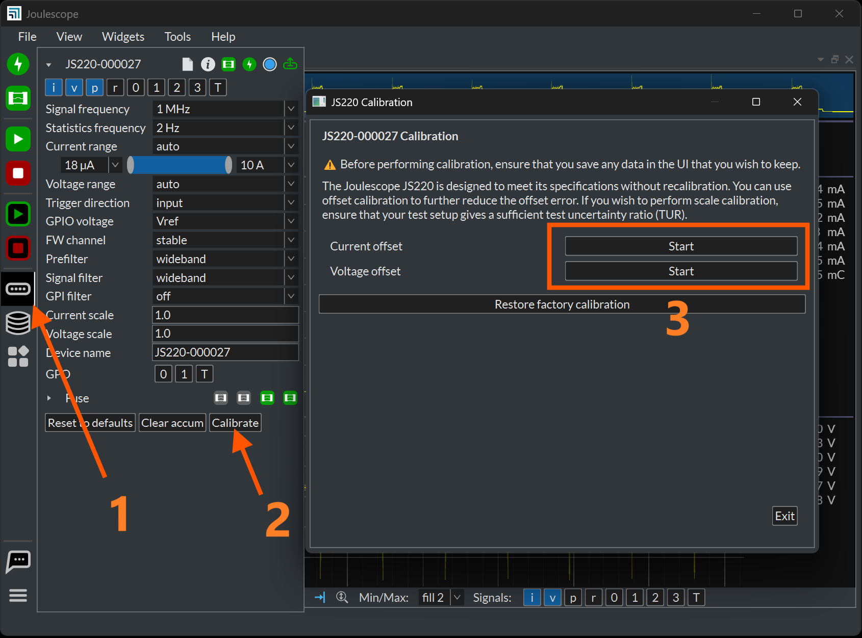

14.2. Offset Calibration#
The JS320 is designed to remain in spec without calibration. However, you can perform offset calibration to improve accuracy for demanding measurements.
The JS320 supports offset calibration for both current and voltage. The Joulescope UI 1.0.40 and later includes offset trim calibration. Before starting a trim calibration, please run your JS320 for at least 5 minutes to allow the temperature to stabilize. To start a current offset trim calibration, select the Device Control widget in the sidebar, then press Calibrate:
Joulescope UI calibration dialog
Press Start for Current offset or Voltage offset, and follow the onscreen instructions. Ensure that you leave the terminals open for Current offset calibration. Short V-, V+ and I+ to perform Voltage offset calibration.
The JS320 uses an internal fixed-point representation of 5Q31 for current samples. 2⁻³¹ represents an accuracy of ±0.5 nA. After performing trim calibration, the instrument offset may be off by up ±0.25 nA.
