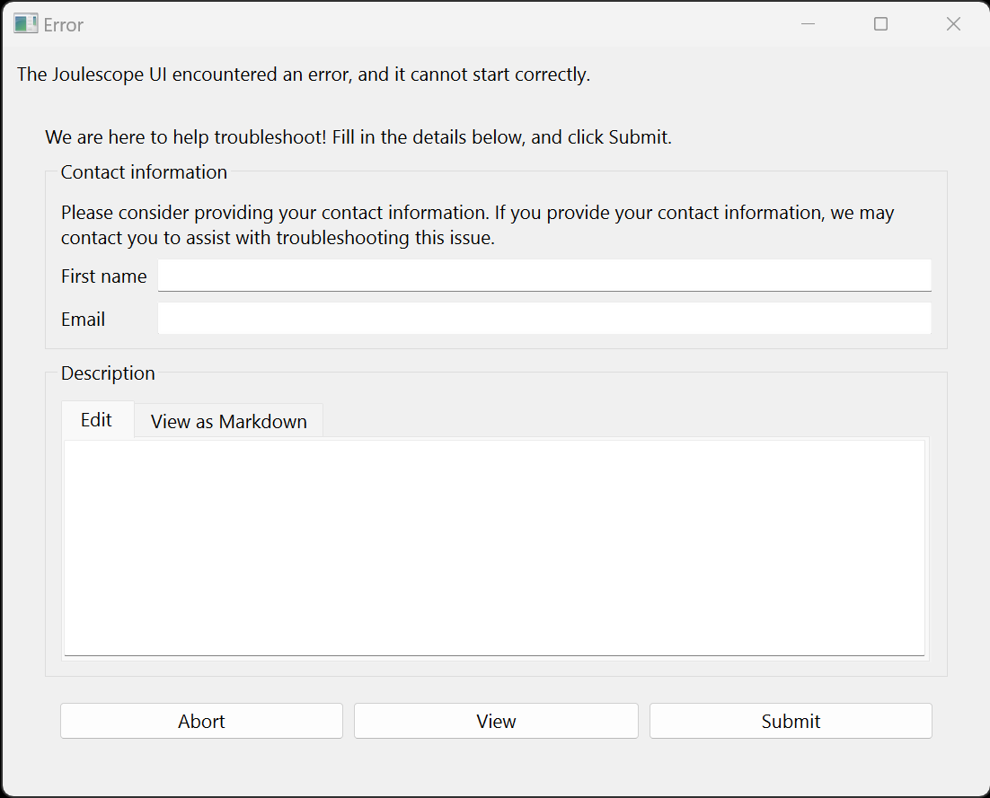

If the Joulescope UI 1.0 or newer does not start correctly, you should see an error window:
Joulescope UI error window
Fill in your name and email so that we can reply to you, then enter a description. Click Submit.
Select either Revert to previous configuration or Revert to defaults for the recovery option on the next page.

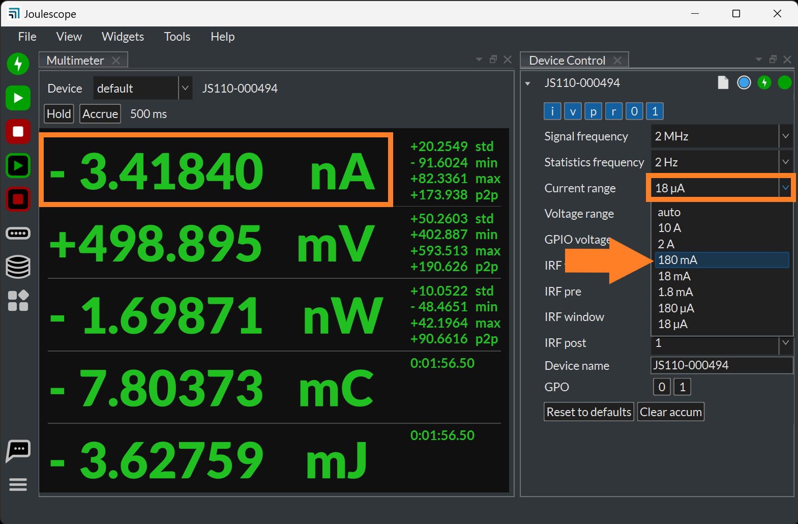

The JS110 is designed to never need recalibration, but it can become damaged. The most common indicator of damage is an offset error in one or more current ranges.
To diagnose this issue, disconnect all cables from the sensor-side IN and OUT. Using the Joulescope UI, manually select each current range and note the offset. Using the Joulescope UI 1.0, select View → Multimeter, then select Widgets → Device Control. Rearrange the widgets. Manually select each Current range in turn, and note the measured current offset at the top left of the Multimeter widget.
Multimeter widget showing the current offset
The current ranges should be within the offset accuracy specifications shown in the current measurement specifications in Section 4. If you find that a current range or two is out of specification, the most likely cause is damage to one of the shunt resistor selection MOSFETs. Known ways to damage these MOSFETs include overvoltage, excessive electrostatic discharge, overcurrent, and reverse current while the JS110 is unpowered.
